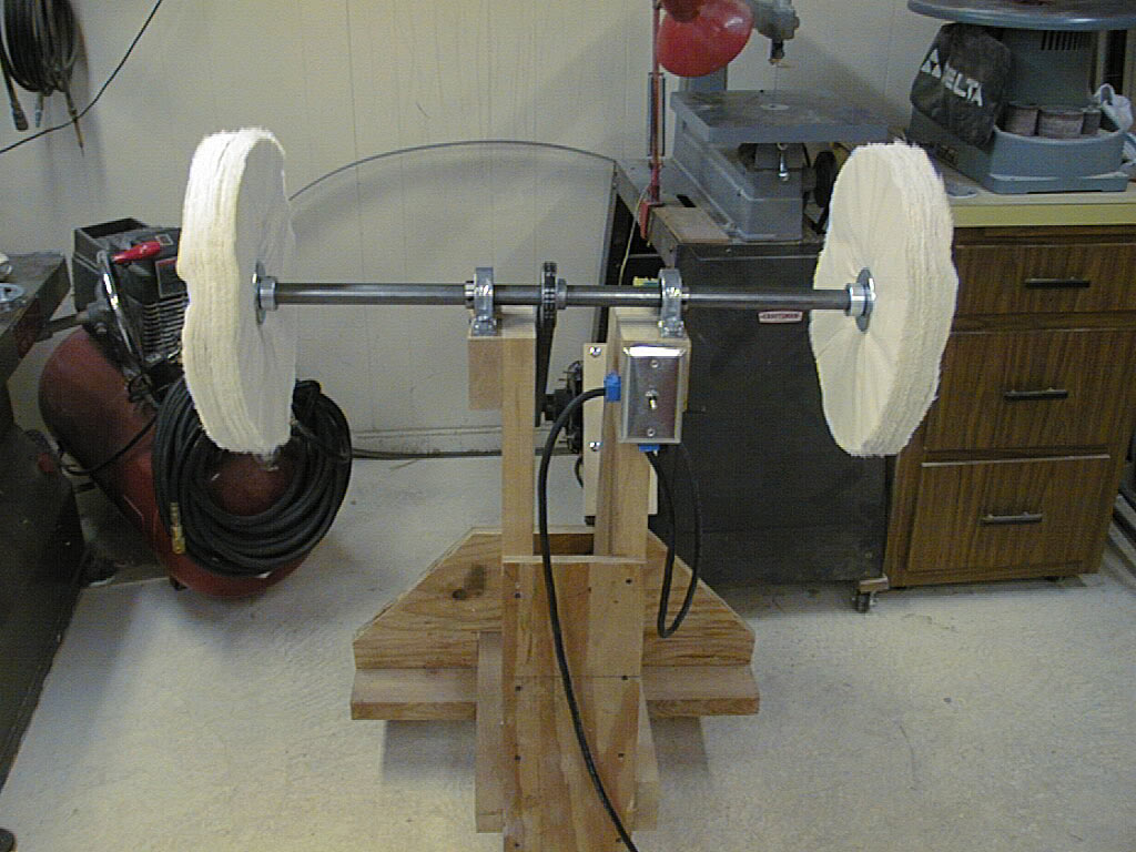

I built this buffing station using the $95 arbor setup available from
Klingspor (#CL34000). It has a 1" shaft and is 32" long. I use 14" canton
flannel buffs from Caswell. You can use a 1/2 hp, 1725 rpm motor. The
beauty is you end up with a no-compromise buffing station for not a lot
of money. I put 2 buffs on each end. You can add more, if you like.
Several people commented on the speed of the 3450 and 3600 rpm units.
Waaaay toooo fast.
Craig[IMG]useruploads/csullivan/2006-01-24_094509_Buffer-1.jpg[/
IMG]

Don't know why the image didn't upload. I'll try again.

Yep, once again I knew the speed was the main issue and only wondered if it could be slowed down.
Love your setup, Craig. That's pretty well along the line of what I've got in mind.
